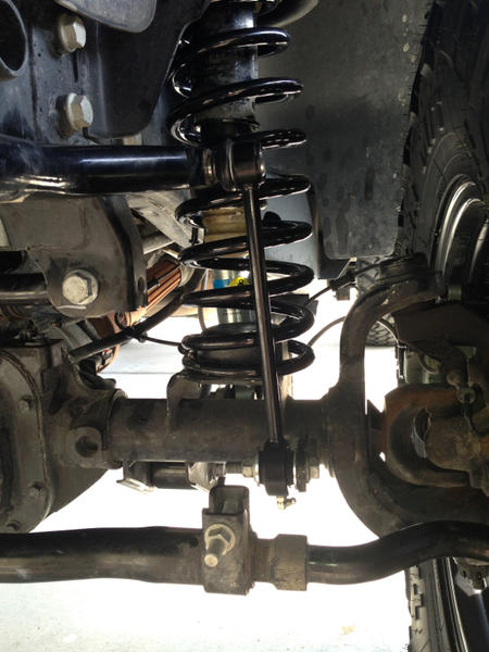

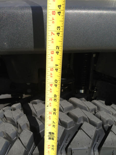

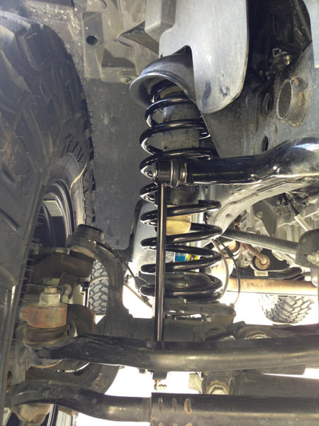

Just finished install the Teraflex 3 inch lift with 35" Nitto Trail Grapplers. For some reason I am sitting 1" higher on the driver side front. I have checked everything a few times an I can't figure it out. This is my third lift install and have never run into this problem.

The springs are sitting in the correct locations, shocks are installed correctly.
Passenger side

Drivers side

Can you post pictures of both sides springs and sway bar links.? You may have a longer spring or stiffer spring then the other.You may have to take them both out measure them and if there different call mfg and have them send you the correct one.

the drivers side spring doesn't look seated right or is it just me
X2. Something looks off on drivers side
Old Jul 28, 2013 | 03:27 PM
not4mall_crawlin's Avatar
Posts: 153
From: Rogers, AR
X3. Looks turned? Isn't there a lip or bracket the spring sits in/on?
