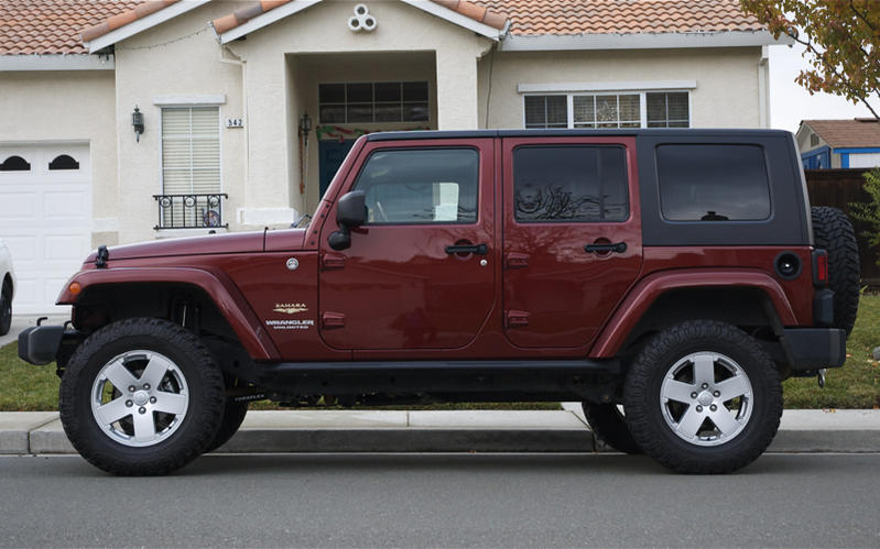

The TF 2.5" coil lift will reduce your front rake. Here's mine with 33s.
I also have front lower control arms and front track bar to correct the front castor and axel shift. I'm now going on 95,000 miles with the lift and don't see any sag or feel any change in road dynamics.
Attachment 422908
Your Jeep looks good. I like the stance. Have you noticed any changes in the ride quality after your TF coil lift was installed? I am leaning this way.

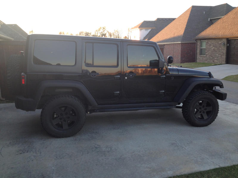

Another vote for TF. I love the ride. I'm still on the stock rubber. My plan was only for 35s in the long run so it worked for my budget. I have the front trackbar with plans for control arms.
ID:	423126   Click image for larger version
