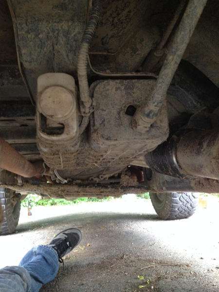

What is this box? It's on the driver side in from of my axle. Does it do something for a vacuum. My jeep is throwing emission vacuum codes:
P0440, P0441, P0456, & P0457
I can see one of the lines is ripped out.
Any input on this matter would be awesome.
Thanks guys!

That's your EVAP can

That's the evap canister. Pulled lines will generate codes and a MIL.
All the codes you posted are related to the evap system.

ohhh sweet. That explains all of my codes being thrown. And I think my warranty covers that. Thanks guys
