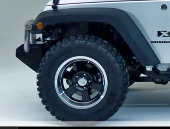

Anyone know the manufacturer of this wheel?

there it is, the big round thing under the fender with the tire wrapped around it.

procomp 8107's

I see they have 4.75" BS, will this cause rubbing? I seem to remember 4.5" is about the max before mods are needed.
Depends on if your jeep is lifted and the size of your tires, with no lift I ran 285 75 16 tires with 5" BS with no rubbing.
Any tire 12.5" (315 mm) wide will rub against the air dam and the front sway bar near full-turn. the air dam is easily trimmed. and the steering stops are easily adjusted to stop rubbing. Been there, done that. My wheels have 4.75 backspacing and I am running 315/70R17's.
Let me know if you need help on these adjustments and I'll write you something with pics.
