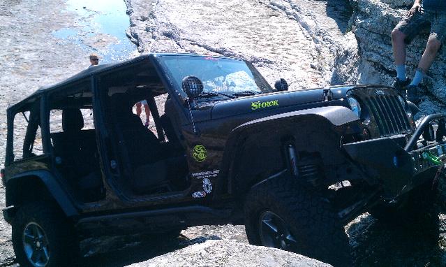

I did put a Aussie in the front of my 12 sport made a big difference. I disconnect & air down, I don't know how it will be on slick winter roads, but in 2 hi you can't tell it there. It does make some noise when turning on the trails but what lunch box locker doesn't. I carry my spider & side gears in my tool box just in case it fails. I have a 2.5" lift with 33s and run level 4 & 5s all day with guys running 35" & 37" tire's.
