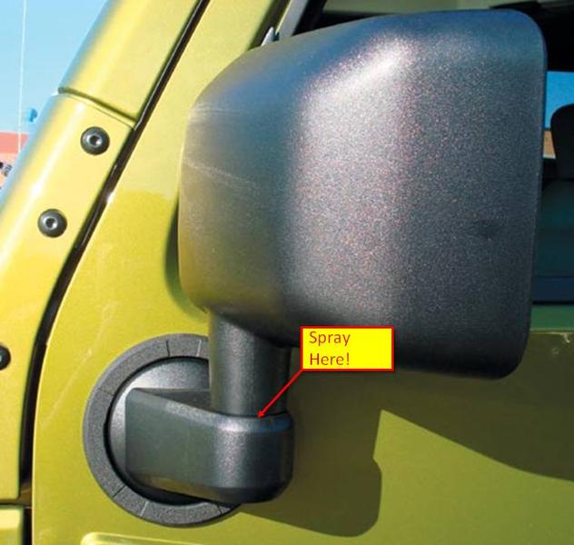

When I installed my Rugged Ridge mounts I struggled too. Here is the problem. Inside the plastic is a cast aluminum or magnesium fitting that the mirror head actually secures to. The union of the two pieces has corroded over time and it is stuck. I sprayed penetrating lubricant into the top of the socket between the mirror head unit and the mirror base unit (See attached picture). I let is sit for about a half-hour, and VOILA! It popped right out!

Dang! Looks like your cut and pound process beat my post.
