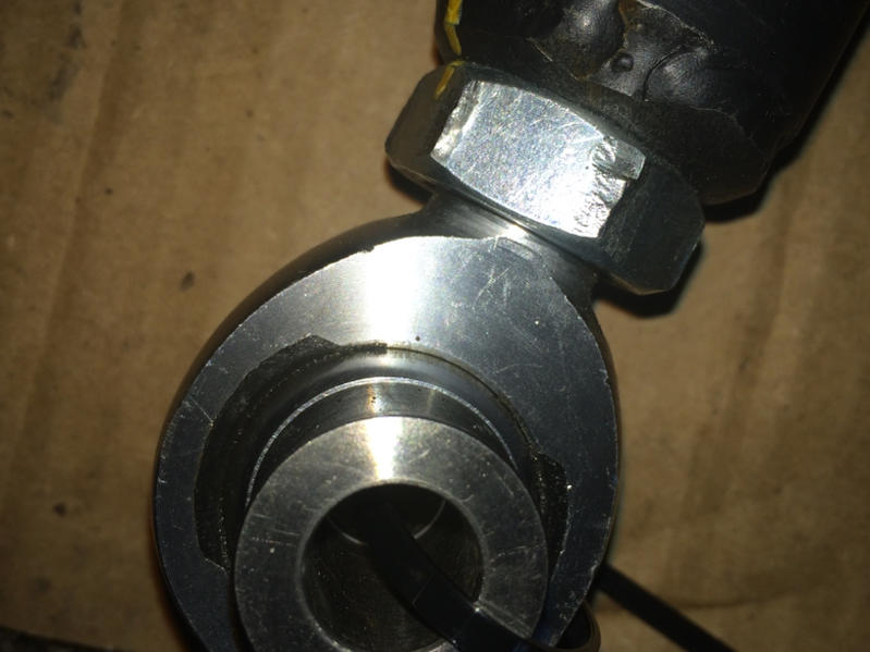

I would take that thing apart and cake with Antiseize. After coat with fluid film.
This is a heim joint coated with FF for over a year in NE.
Not a single bit of rust.
