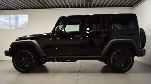

I want to lift my stock 2013 Jeep Wrangler 2.8 CRD Moab, to mount 33-35" tires, andkeep all the rest original bumpers etc. Not sure if the (Rubicon) wheels willbe OK, so I need some help of experienced members!
I drivemostly highway miles, so a decent drivability is very important for me.
Attached enpicture of my JK.

Read the sticky at the top of this forum https://www.jk-forum.com/forums/modi...-lifts-288269/
There are a lot of companies that make RHD CRD compatible lifts. Teraflex and AEV both do. You don't technically need to lift your jeep to fit 33-35" tires, just some wheel spacers and some strategic trimming.

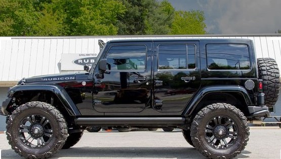

Thanks, but I want to keep everything original, so some lift will be required!
This is what I would like to achieve...

That looks like a 3.5" lift with 20 inch wheels and 35s. It also has AEV bumpers.
You do need to have the correct backspacing on the wheels, typical is 4.5" for a 35x12.5 tire. You can get that with a 1.5" wheel spacer and your stock wheels. Depending on country or state/province you may not be allowed to run spacers.
