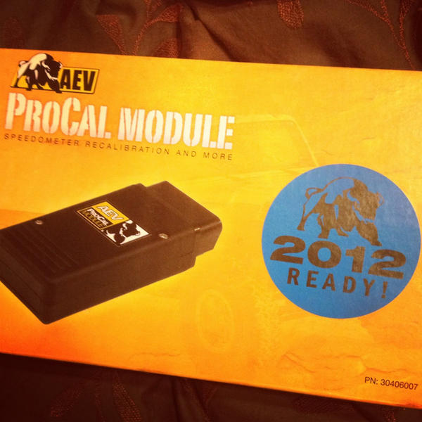

so the PROCAL is NOT set up for the 12's ??????
Old Jun 9, 2012 | 05:33 AM
Fivepack1966's Avatar
Posts: 102
From: Oneida,il
Yes it is, but you'll have to get a new one. It'll say right on the box 2012 ready.
what he said, you will need one specific for the 2012

This is what you need.
I'm running 35s with 3.21 gears and after ProCal it feels just like my stock Jeep. I originally planned to regear but the guys at EVO told me wouldn't be necessary. I would still eventually like to but they saved me a lot of cash I was able to put towards other things for the time being.
