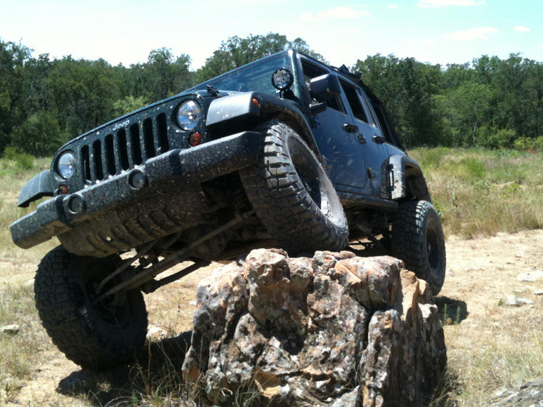

Old Apr 29, 2012 | 06:55 PM
Lucas's Avatar
Posts: 464
From: Corinth, tx.
Wife by jeep while flexed with factory fenders and bumpers
Same rock diff view.
