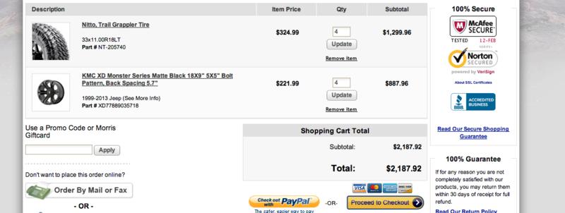

Hey everyone so I have made my decision on my rim and tire selection. I just have some questions with back spacing and If I need to use a wheel spacer. The picture below is the setup I am going to purchase for my 2011 JKU that currently has a 2" full traction leveling kit. Now I noticed on the site I can have the rim have a 5.7 or a 4.53 back spacing.. What would benefit me more with a 11 inch tire? I want somewhat of an aggressive look but this is going to be an everyday driver so nothing to crazy. Thanks for your help!
Also one more thing I just want to double check the bolt pattern on a 11jku is 5x5 correct?

5x5 is correct. depends how far out of the fenders you want your wheels/tires. 4.53 bs will push them out a bit and the 5.7" bs should keep them inside the flares. I have 4.5" bs on mine would perfer something with around 5-5.7 just so the tires were tucked in a little.

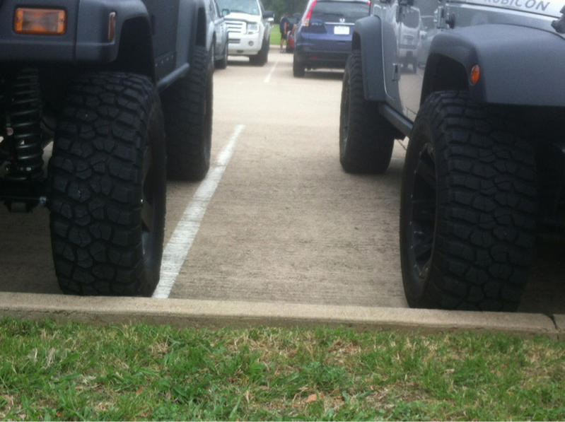

If you ever go wider, you will want the 4.5. It doesn't stick out much.
Attachment 421582
i just realized you attached the picture.. the set up on the right how wide is that tire? because that i could live with and also did you use a wheel spacer? or was the 4.53 enough?

They are rugged ridge 17x9 and are approximately 4.5
Technically I think they are 4.6
The width is 305 and measures 12".
305/65R17
That is my JKU on the right. On the left is a TJ with a 285 width BFG M/T
