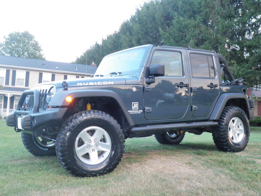

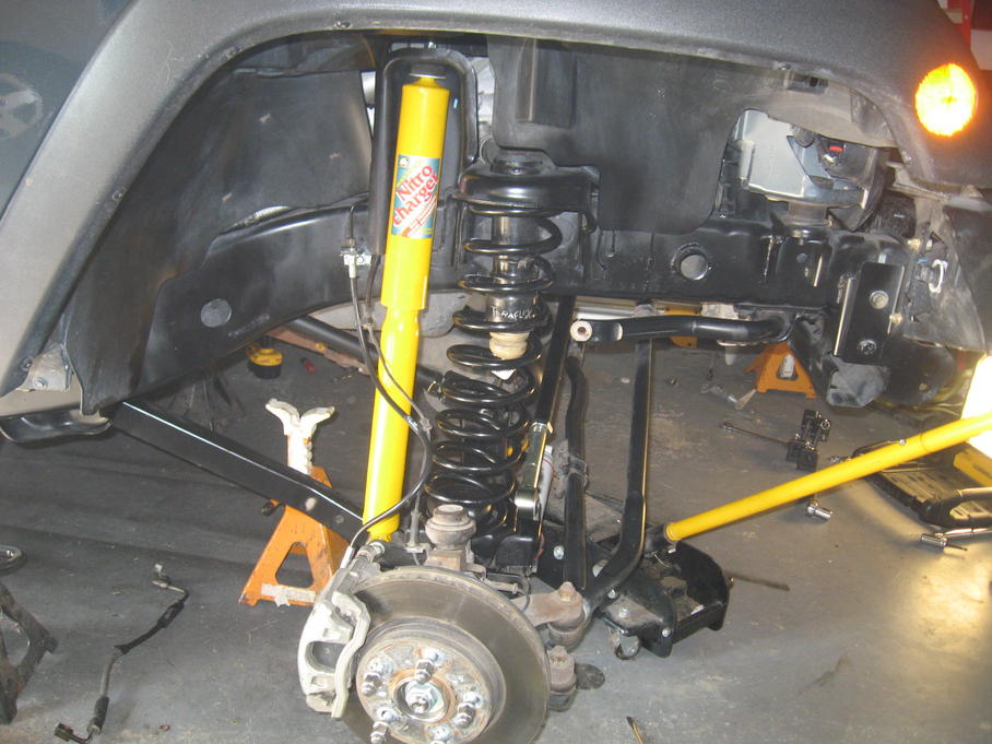

I have the HD coils and love them. They ride great. However I would not just put the springs and shocks in and call it a day. At the very least I would add track bars, front lower control arms, brake lines (atleast drop brackets) and bump stops.
But to be honest If I was on a budget and only fitting 33"s I would get the Teraflex 2.5 " budget boost. It maintains your stock ride and won't cost you an arm and a leg. It will allow you to upgrade as you go along. I would def. get new shocks with the budget boost and not use the shock extensions. Just a thought. They are easy to install and get the job done.
If you still want pics of the OME kit here U go.
