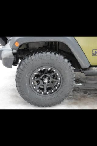

I'm running a 2.5 bb from rubicon express and have 33x 12.5's on it right now. Looks real good but you are always going to want bigger

I have a 2dr automatic. I have the teraflex 2.5 bb. I put bfg km2 35x12.50x17 on. I didn't notice any power loss. It looks great in my opinion :-)
