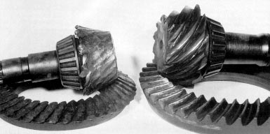

TAKE IT BACK ASAP......trust me my gears whined since I got them done and now 1800mi later I have to get them replaced. The shop I had mine done just couldnt do gears and shouldnt be doing gears, I wont be taking it back there. Yours are making more noise then a whine is really bad, makes you wonder if they even test drove it after they were done. I wouldnt drive it either. Tow it flatbed only. Call the shop in morningand tell them to send a tow on their dime.
pic of my gears after 1800mi....you can see the pinion gear chipping apart
WOW>>>>>>
