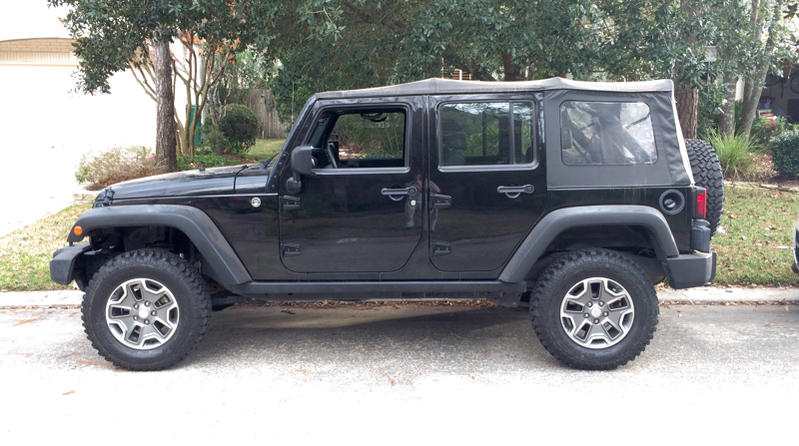

Check out the Rock krawler 1.5in spring with a set of rancho adjustable shocks. I have those springs and bilsteins and really like the ride but it's not as soft as stock. With the ranchos people say you can get that softer ride you are looking for.
