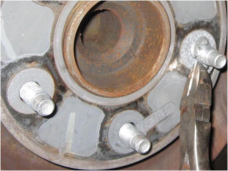

This is what we are talking about.
Name:	Stud washer.jpg
Did you remove all of them ?

When you installed the spacers, did you pull off all of the small metal rings that were on each of the lugs? These are installed at the factory to hold the rotors in but must be removed before installing the spacers. Otherwise, the spacers will be "tightened" to the correct torque, but not be flush against the rotors and will cause an imbalance...
Ok so if I remove those that should get rid of the wobble??
Old Jul 31, 2012 | 07:53 PM
scooby snacks's Avatar
Posts: 4,343
From: Wake Forest, NC
Yes, this things will keep your wheel spacers from seating properly. Take some tin snips and cut them off!!
