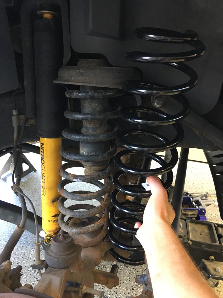

Well I may be stuck on this job right now. I don't think I ordered the correct springs? Maybe I have the MD in the front and not the HD. The axle is slightly lifted right now but I can't see all of this coming down that much further.

I wrote in my notes I got the 619/617 lift.
I replaced the rear about a year ago and upgraded to the HD in the rear. They say 615 on the rear coils.

Ok got it! I'll posts pics of the final.
