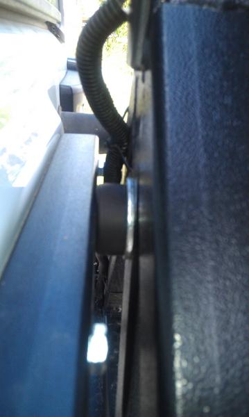

So I took a few pictures. I am hoping I could get some more feedback. I have a new theory on my thud issue. The one picture is of the rubber bumper on the tire carrier. With a help of a friend who works at a 4wd shop, we were able to pull the tire carrier away from the door enough to possibly cause it to bang against the door on bumps. Not to mention the fact that I am still running the more lightweight OEM wheels/tires, and the carrier is designed for a bigger wheel, which would help to weight it down a bit more in back. So, I am going to move the striker plate on the bumper a tad bit more forward so it closes tighter thus pushing the bumper up against the door harder. I am also going to place another washer or two under that rubber bumper just to ensure it is as tight as I can get it with the OEM's. This is my first area of suspicion.

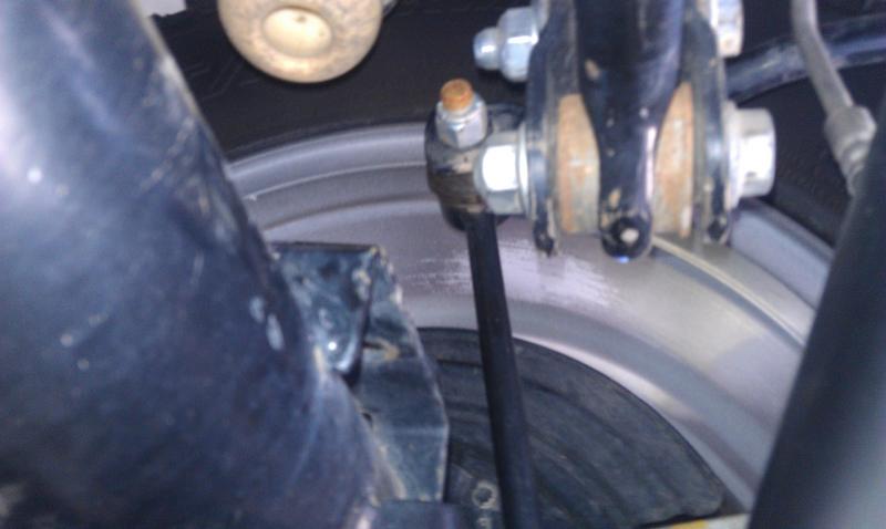

The other pix are of the passenger side track bar mount bolt. Again, even though the bolt is facing forward, I don't see how that is going to come into contact with the bumpstop plate. And there are no signs it has been hitting.
The other is the distance between the muffler/exhaust and the frame. Considering how little it takes to provoke the sound, it seems this is okay. The grommets are intact. The shocks are solidly in place, so again, not my first suspicion.
