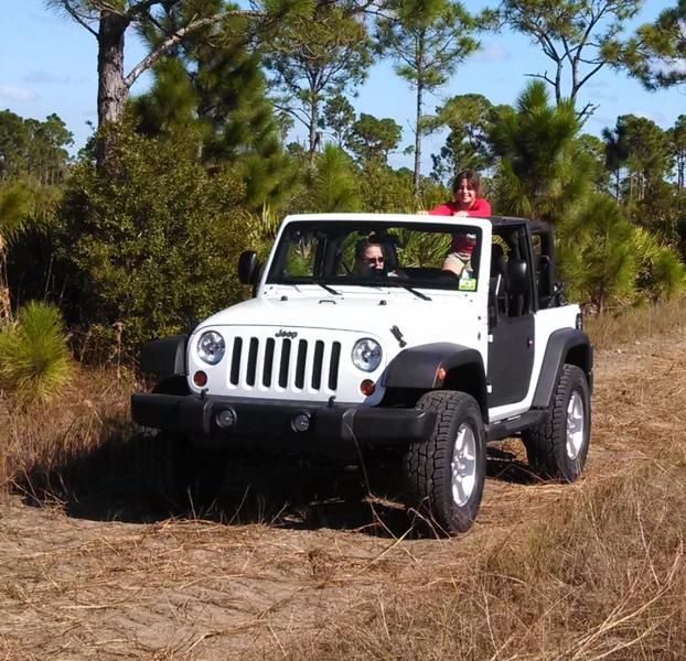

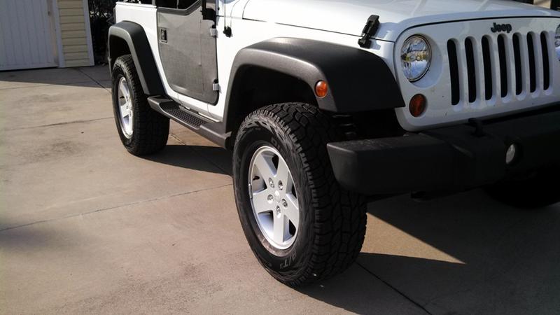

Throw the Cooper Discoverer AT3's on your list.
I love them. Mine are the P285/70/17's and have a great deep-open tread pattern. They are almost silent running down the road.
They have great wet traction too. This size weighs only 45lbs per tire and has a 55,000 mile tread wear warranty.
The LT version in the same size weighs 5 or 6 lbs more per tire. Some LT's in that same size weigh close to 60 lbs ea.
Stock wheels with 2 in. lift and 1.5 in SpiderTrax wheel spacers.
Attachment 530870
Attachment 530871
I agree with the Cooper AT3's Put a set on the wifes' JKU about 2 years ago, and couldn't be any more satisfied. They are great on the highway, and in the rain. Couldn't believe how well they gripped in the recent snow we had here in Lancaster Pa. With that said, I put a set of WildPeaks on my F150 4X4 supercab, and they are good tires, however I like the Coopers better.
Can't understand why Cooper AT3' and the ST's are such an overlooked tire. Good looking tread design that works well in the rain, snow and highway. Quiet on the highway at both low and high speeds. Easy to balance, and after 2 years looks like the wifes has had little or no wear. Great price and a 55K warranty.
