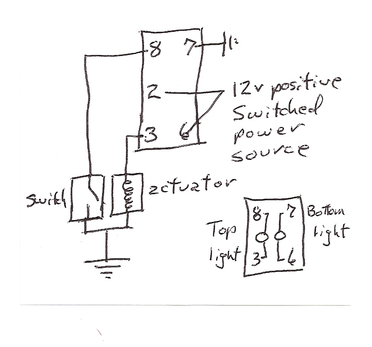

I would suggest wiring the lockers to an spod.
Add a secondary set of otwraw switches as safety switches (dual led)
Use the ground that comes off the sensors at the lockers to turn on the upper led on each safety switch.
This is what I did and it works great!
You can accidentally turn the lockers on when you don't want to and you have an indicator that tells you when the lockers are engaged.
Some times they stay locked for a bit even after you unlock them. Very good to know!

Yup, you can add a safety switch to the OTTRAW switches so you don't accidentally activate the lockers while doing 70mph. Mine are wired so the large LED lights when I hit the switch and the bar LED lights when the lockers actually lock. These switches aren't active unless I hit another switch (to provide the OTTRAW switches power) that is on the other side of the steering column from the locker switches. These might help a bit. Plug '1' (small plug) is your actual locker while plug '2' (larger plug) is the locker indicator.
