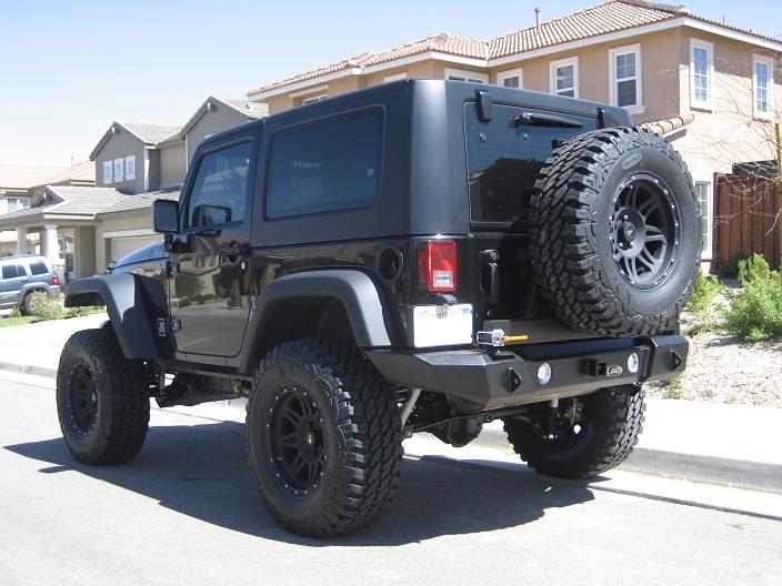

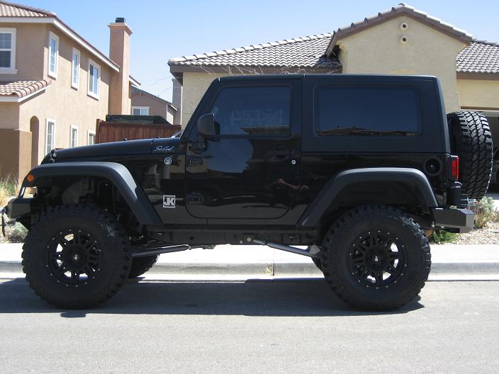

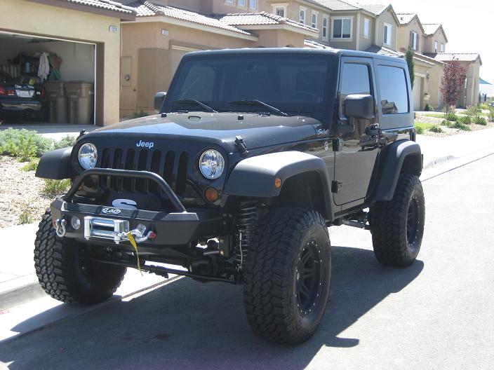

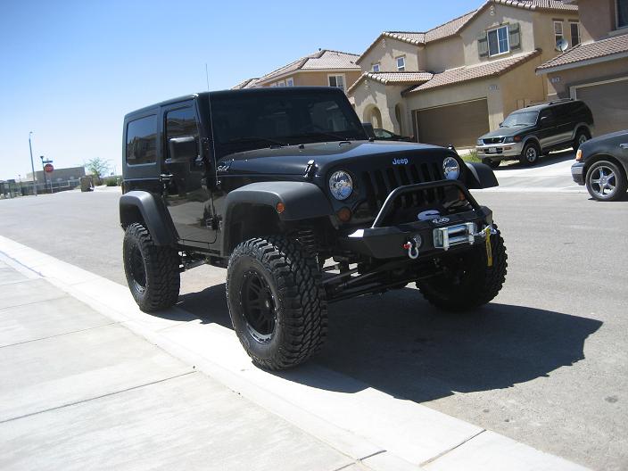

Originally Posted by SoCalChuckster
I went with a 5.5" long arm kit and stayed with 35's. The lift/tire combo look awesome in my opinion
Chuck
Can you post a picture please? I am still undecided about whether to go with 35's or 37's and you do bring up a very good point. Thank you for your response.

here you go...plus with 35's you have more room to flex and wont have to spend extra money on new fenders when you rip them off lol.
Chuck
