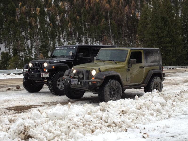

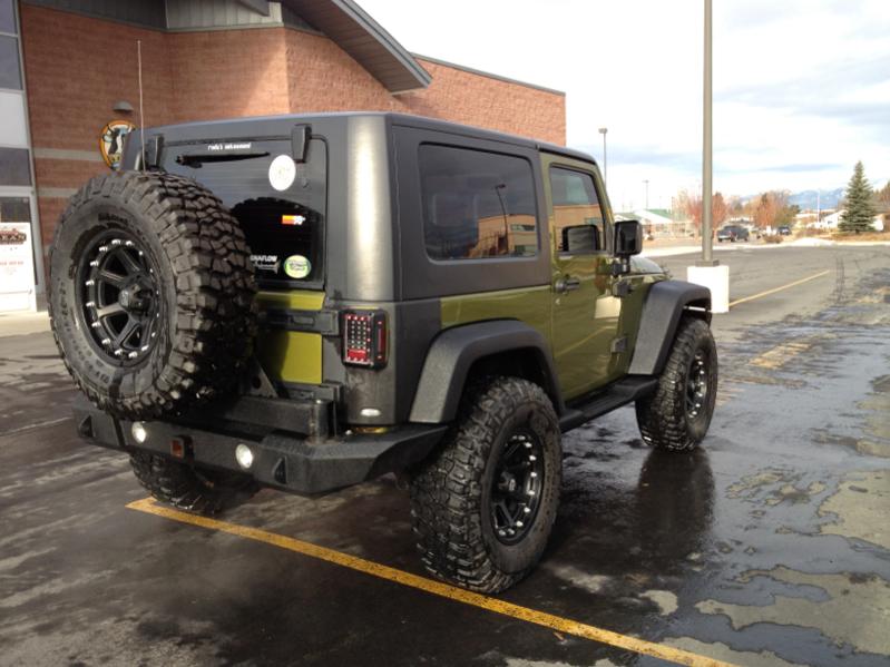

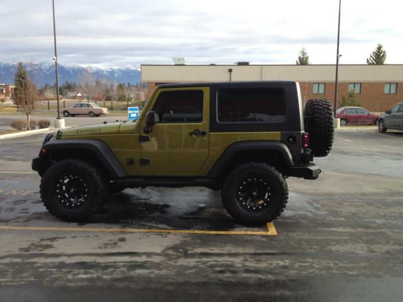

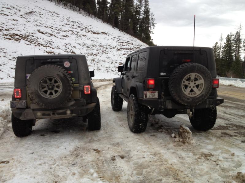

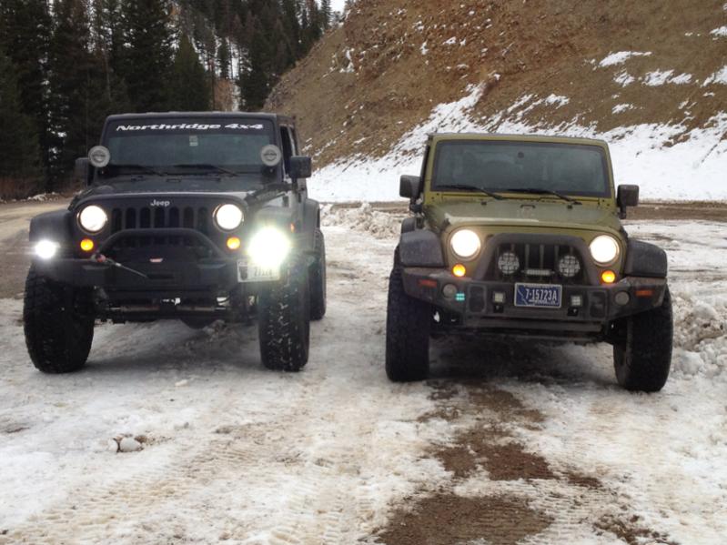

I currently run the teraflex 2.5 budget boost with 35x12.5x17 km2's. It is a killer setup. Some people choose to add sleeves and gussets when 35+ tires. I did, but it's not 100% necessary unless you wheel a ton then at least do gussets. Also with a 35" spare you probably won't want all that weight on the tailgate. So a rear bumper tire carrier might be wise. Other than that. Cost wise there isn't much. I would definitely go 35's you will want em as soon as you have had 33's for a few days. I know I already want 37's
Here's a few pics of 35's on 2.5 bb
The other jeep And jeeper pictured is forum member bstelling. He rocks the aev 4.5 with 37x12.5x17 mtr/k
Hope this helps

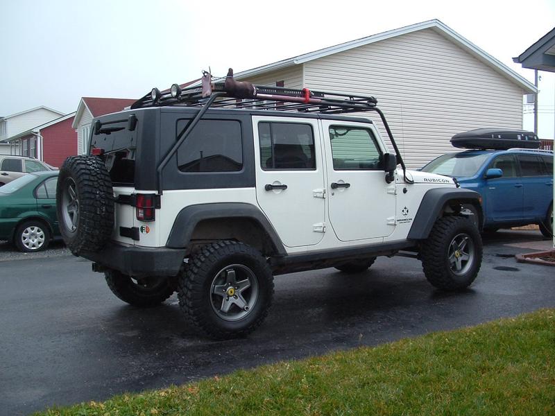

Thought I would share a pic of my Jeep when it had a 2" lift and 33" km2's and stock fenders. I found that the 33" tires looked small with the lift and I either should have ran the 33" with no lift or gone to 35" with the lift. Of course, I had the bug and now run 37" tires.
Good luck with your choice.
