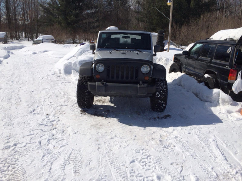

I have the 285/70-17 on mine with 17x9 with 4.25 back spacing and they work good tire isn't stretched or anything

Nice,kinda looks like mine. What color?

Bright silver 2 door had the grille plasti-dipped but I peeled it all off and left the letters black
