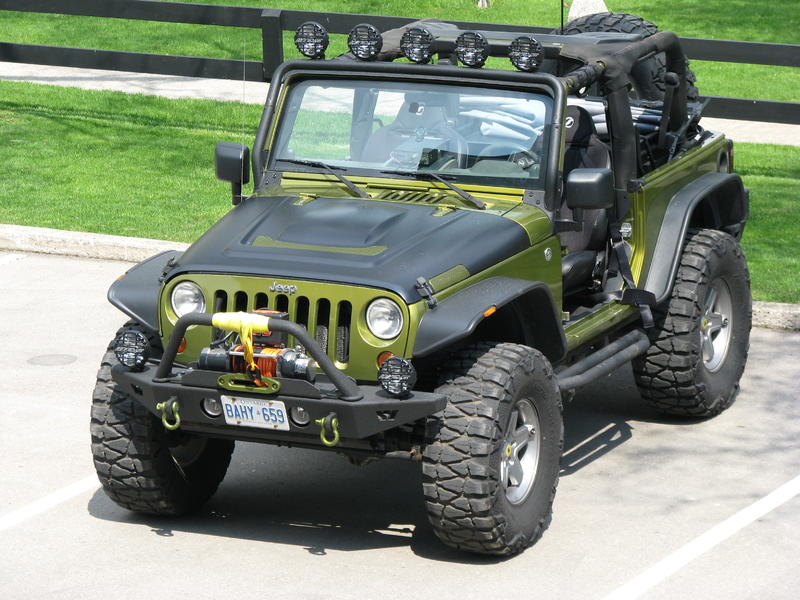

Now that I am done with my mods for now, I want to save for a hemi swap in say 4 yrs. I have a 07 2dr standard. I want to remain as a standard. I have a 44 back and a pro rock 44 front. I will most likely go to a dana 60 in the back at the time of the swap. Now where did you's guys out there get your motor and transmission from or did you get a crate engine and transmission new. What vehicle did you search for , for your hemi? Any info would be helpful. If I find a hemi now ,what do I do to it to lay it up for a couple of yrs? I like the look of the 6.1 as to the 5.7 with the plastic top cover. I would start amassing parts as I go and when In have all the parts its go time. Thanks for your replies.
