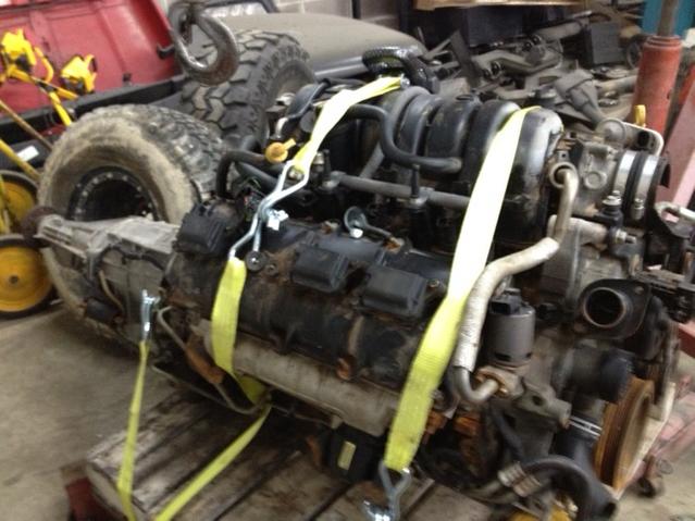

Default Getting my Hemi in a few months!!
A couple of months ago I just purchased a GREAT deal!! Just got a 5.7 Hemi with transmission out of a 2011 Jeep Commander that was in a rollover accident for $1,000.00. It only has 7456 miles on it. I'll take some pics of the engine and transmission. I'll need some help on what's the best kit and method of putting this beast in my JK. I've already noticed that I'll need to do some work on this , some parts are broken and the wiring harness has been cut in a few different places. So I'll need some expertise on this project from start to finish. But I'm on my way to more power and joining the HEMI club

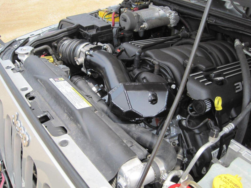

I also have a 2008 Rubicon, Burnsville off-road did a 5.7 vvt 2 years ago. The check engine light was on for over a year. And then none of the sensors work so it would not pass inspection. I was told by Dan at Moab last year if I switch to the 6.4 VVT motor, that I wouldn't have these issues so. I paid Dan $12,000 to swap the motors out. When I got my jeep home the check engine light is not on anymore, but it still won't pass inspection the computer is not right ( Not reading the Sensors) I'm out $33,000 on Motor swaps and don't have a jeep that will pass inspection.
