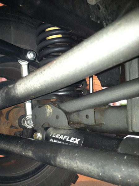

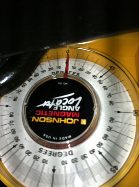

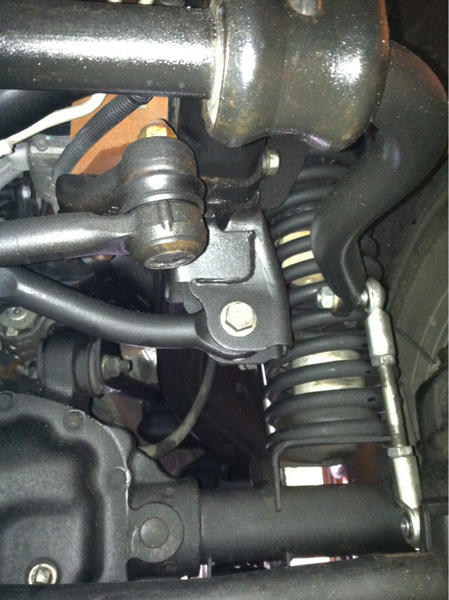

Got my wife's jeep with the lift already installed. She's been reporting some wander issues and minor DW.... Think this caster angle has anything to do with it ...... Lol. Time for some new CA's
Nevermind no adjustable trac bar or even bracket on the front

Originally Posted by Jayrubicon
Got my wife's jeep with the lift already installed. She's been reporting some wander issues and minor DW.... Think this caster angle has anything to do with it ...... Lol. Nevermind no adjustable trac bar or even bracket on the front
Wow. Maybe whoever installed the lift thought 0 was good?
Lol... Right. Zero it out and it's perfect!
Looks like some ACA's or AEB drop brackets are getting ordered.
Never had a vehicle off caster by 4.5 to 6 degrees. Holy hell

Originally Posted by olyelr
How much lift? Stock control arms?
Looks to me to be a 2.5 to 3" lift. Bottom of frame to top of axle measures 7.5".
Stock CA's.
Weird thing is it has a trac bar relo bracket in the back!
Jackasses
Stock CA's.
Jackasses
Originally Posted by Bonedoc
I wonder if they had any parts left over after the install.
It is amazing what some people will do!!
The Teraflex 2.5" spring lift (which is typically around 3" or more I guess) comes with nothing for the front. No trackbar or bracket, no lower control arms. Nothing.

Originally Posted by otservice
A 2-3" lift generally doesn't require any extras such as an adjustable track bar up front. In the rear it does though. Is the axle way out of alignment side to side? Or is it just the castor?
Axle is about 3/4" to the drivers' side.
Well if a lift that size can completely zero out your caster or put it in the negatives they definitely should!
