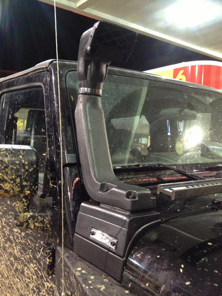

Went with the rugged ridge. Pretty simple install. Only problem was the gap it left between the base and the windshield. So we cut the old cowl piece, tach welded it to the side panel and no more nasty gap.

Old Oct 27, 2012 | 10:10 AM
eumel789's Avatar
Posts: 491
From: Boynton Beach, FL
Cool
Originally Posted by DeucesALLin
[ATTACH]373526
I hate the rr brackets though- usess on the street. Going to make a hard bracket off the windshield.
Nice job. Just make sure to get a cover for the opening!
Old Oct 27, 2012 | 10:44 AM
DeucesALLin's Avatar
Posts: 1,106
From: Houston,TX
Nah- i used the factory air box and a 12" K&N so all the debris collects there. FYI i use a cig to test vacuum before deep crossings as ive seen more than one snorkel fail during wheeling
Old Oct 27, 2012 | 10:46 AM
Posts: 1,106
From: Houston,TX
<img src="https://www.jk-forum.com/forums/attachment.php?attachmentid=382850"/>
Wow, all that and you still had to weld?
Welcome to the depthfinder club!
