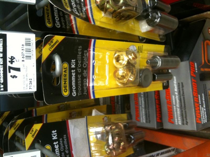

Let me look up my old write up. I made one last fall and it has worked spectacular. I got all my gear from Home Depot.
Can't find the write up, but did find the photos. Basically I used 1 roll. I don't have any pictures of it installed right now, When I head back home next week I'll throw it on since it's getting warmer outside.
I cut 1 roll of this: Click image for larger version
ID:	296237 , I didn't cut any off the sides and there's no sun line coming from either side. I did however cut it to 72" in the rear. It hangs down about 4" for me below my rear roll bar, just like I want. I used all the grommets, 2 boxes I believe Click image for larger version
ID:	296239. I went a bit overboard though. It doesn't flap at highway speeds. Lowers the temp 10-15' immediately. Can still see through the top, and my 70lb dog didn't fall through when he jumped up there.

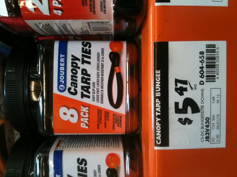

I also painted my orange balls black, much nicer that way. Click image for larger version
ID:	296240 Bought 2 of these I think, as well.
I paid ~$40 I believe since I already had the grommet tool. I spend an afternoon doing it.
