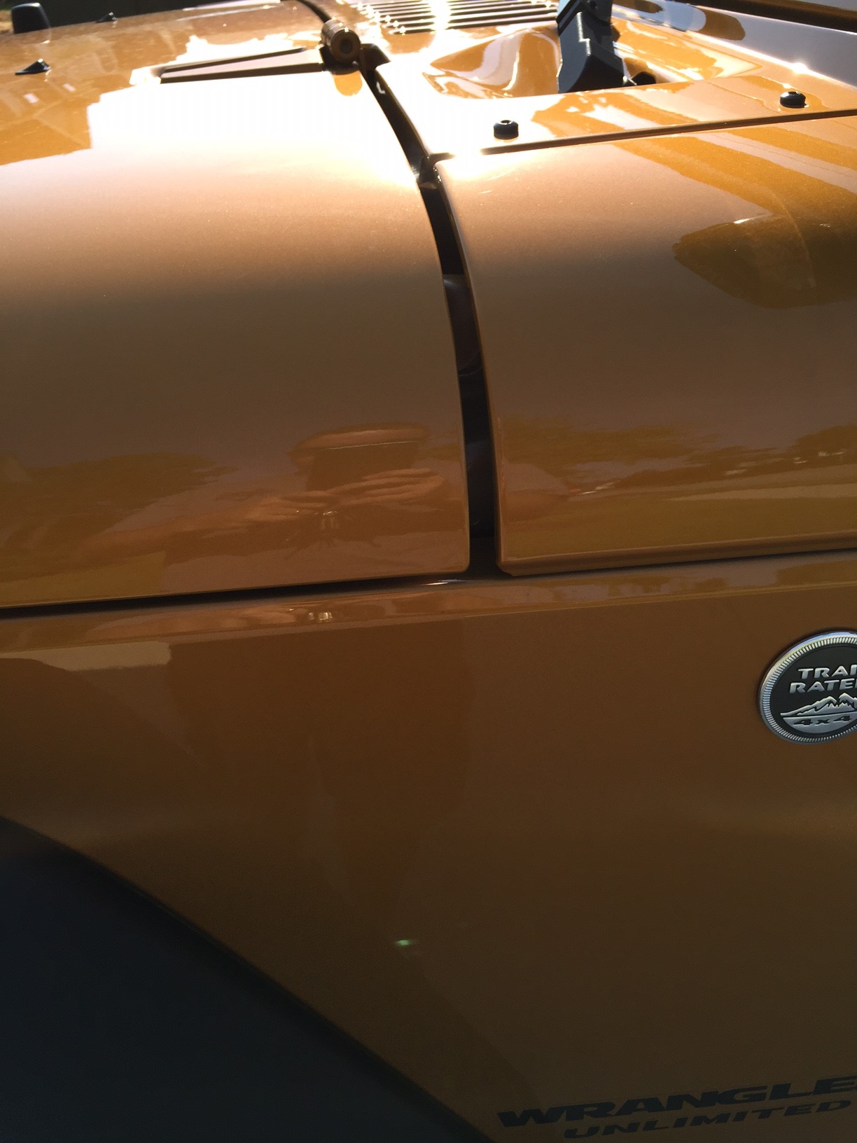

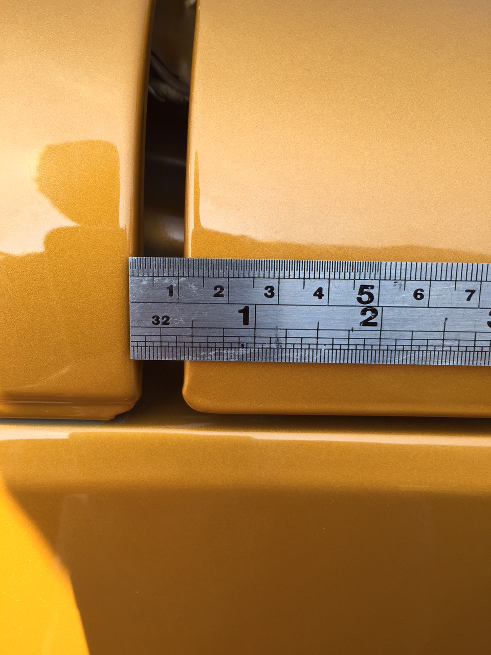

Now fast forward to this morning, I was fiddling with my sPod and running some wires down the a-pillar when out of the corner of my eye I noticed that the gap where the hinges meet hood looked a little wider then usual. To be transparent, I never measured the pre-install gap, so it could have been that way all along. After cleaning up my mess, I jumped on the computer and did a little digging. It seems that there have been a load of folks that installed hood lifts and have ended up with bent or deformed hood hinges (mostly Teraflex kits).
So my question is...with the hood down and latched, how wide should the gap be? Mine is currently .50" on the driver's side and .437" on the passenger's side. If I give the hood a firm push, the hinges flex and the gap appears to sit properly. I know just about every JK will have a slightly different measurement, but there should be an average. Can some folks take a moment and snap a couple of picture or take some measurements and share them here?

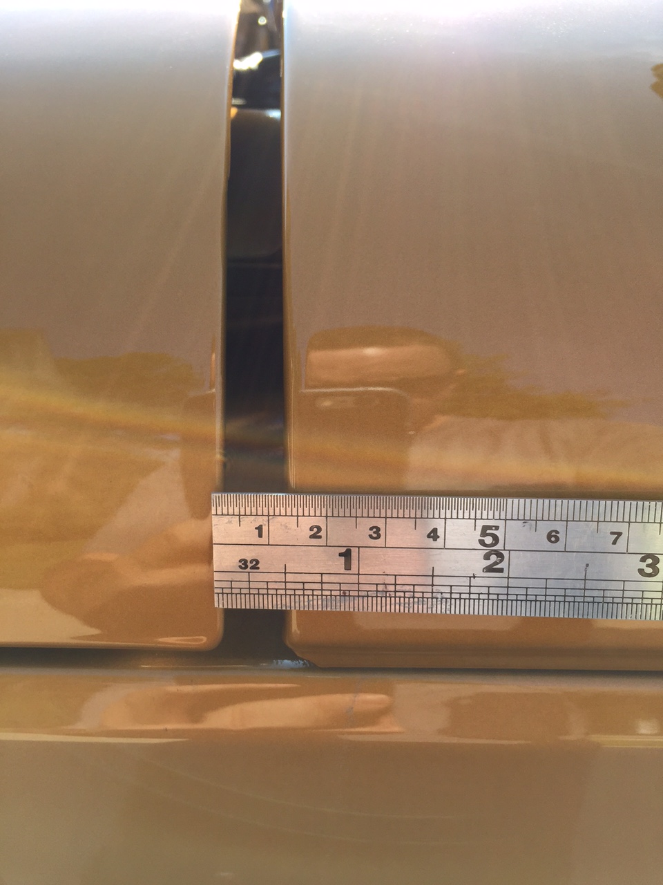

In any case, they're on. After closer inspection this morning it indeed looks as though the hinges are bent, but without some reference photos I can't be sure. Can someone with personal experience using these chime-in or maybe someone take a few comparison photos of their rig for me to see?
The hinge sure looks bent to me... I may look into some stringer hinge plates... not sure at this point.

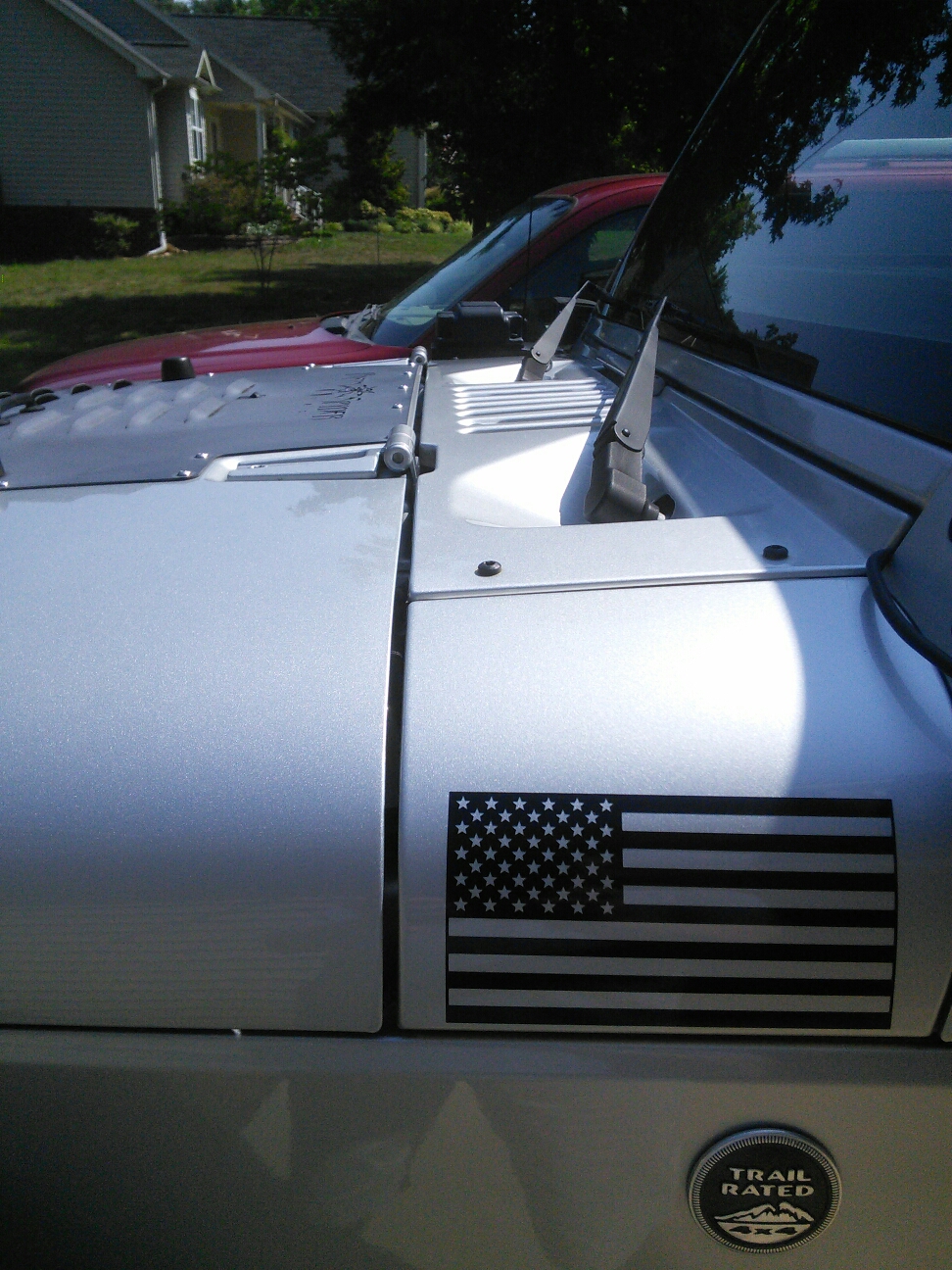

Here are some photos of my hood with no struts...roughly 1/4" gap
Thanks for the photos...looks about right, def pushing the hood forward.
