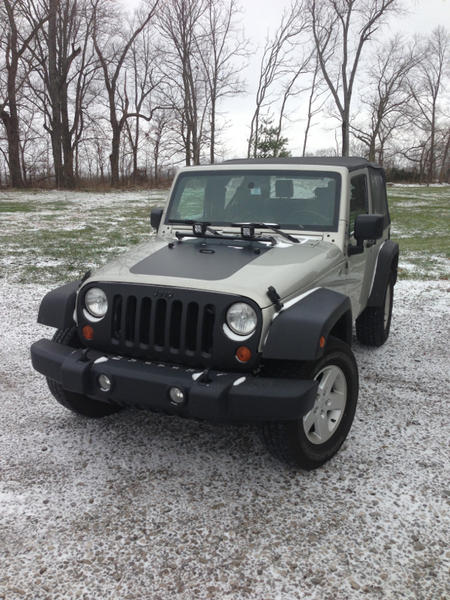

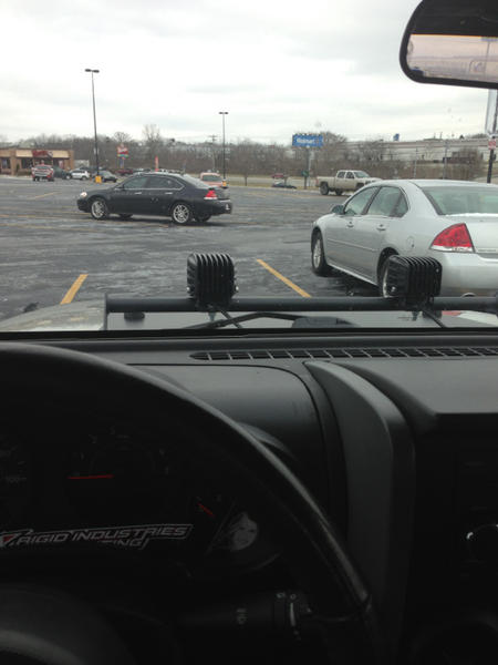

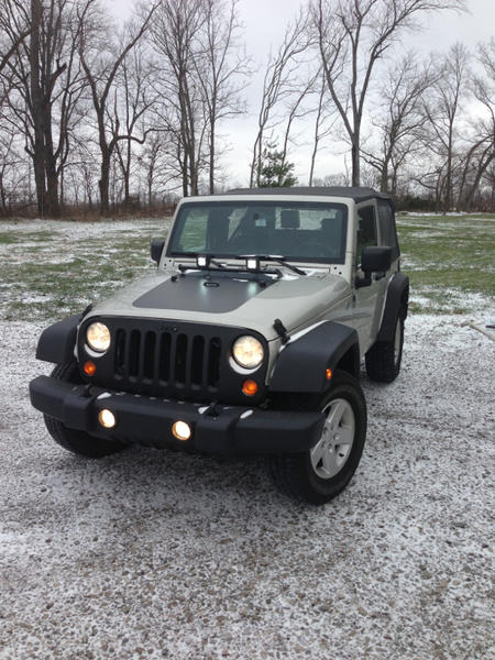

Decided I would do something that I haven't seen anyone do. I put rigid duallys on a hood light bar. The bar is made for the KC lights that a rectangle but I thought the duallys were not much bigger. Wired them up just light you would the windshield mounted lights but ran the wire between the hood and the cowl. The glare isnt bad especially because of the blackout sticker. And the lights are not bad to see over while driving. I liked the setup and thought I would share it.

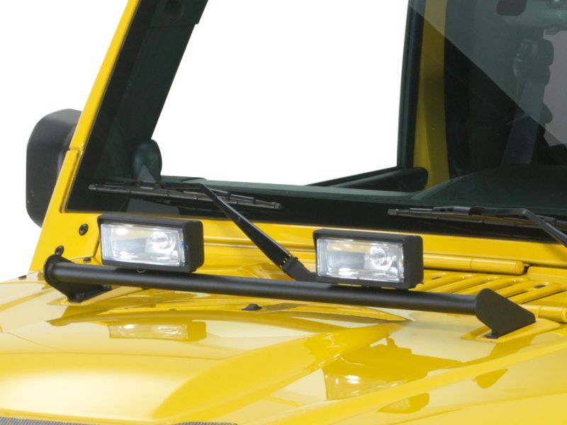

so you just used the standard kc light mount....like this one..
then did you use diff mounts to hold the 20" on it ?
Old Oct 22, 2013 | 09:03 PM
White-JKU's Avatar
Posts: 337
From: Midwest
Attachment 507434
Yup I used that exact mount. As I said before I used the holes that hold the lights for the hi lift with bolts. I drilled two holes (one on each side) to put a bolt through to hold the 20. I used the little foot mounts then give you and put a bolt through that and the holes I drilled in the KC mount to hold it.
Old Oct 22, 2013 | 09:05 PM
Phantom10's Avatar
Posts: 26
From: Walter Hill, TN
sweet! i wanna do a combo mount like that on the hood.....and this thing is only like $40.....thanks bro!
