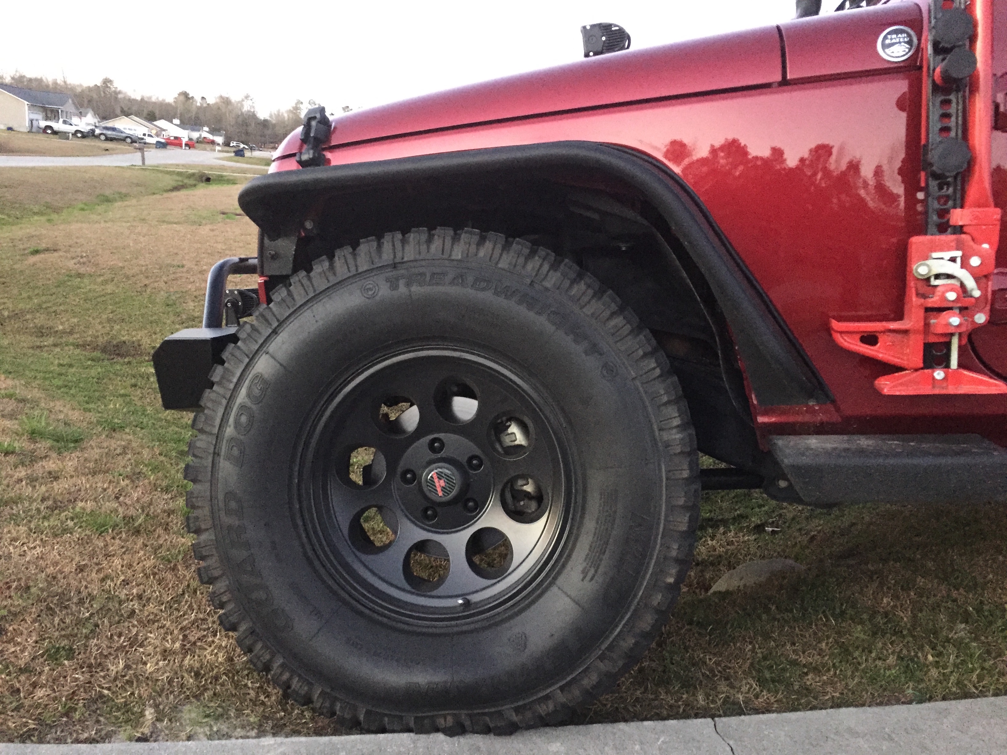

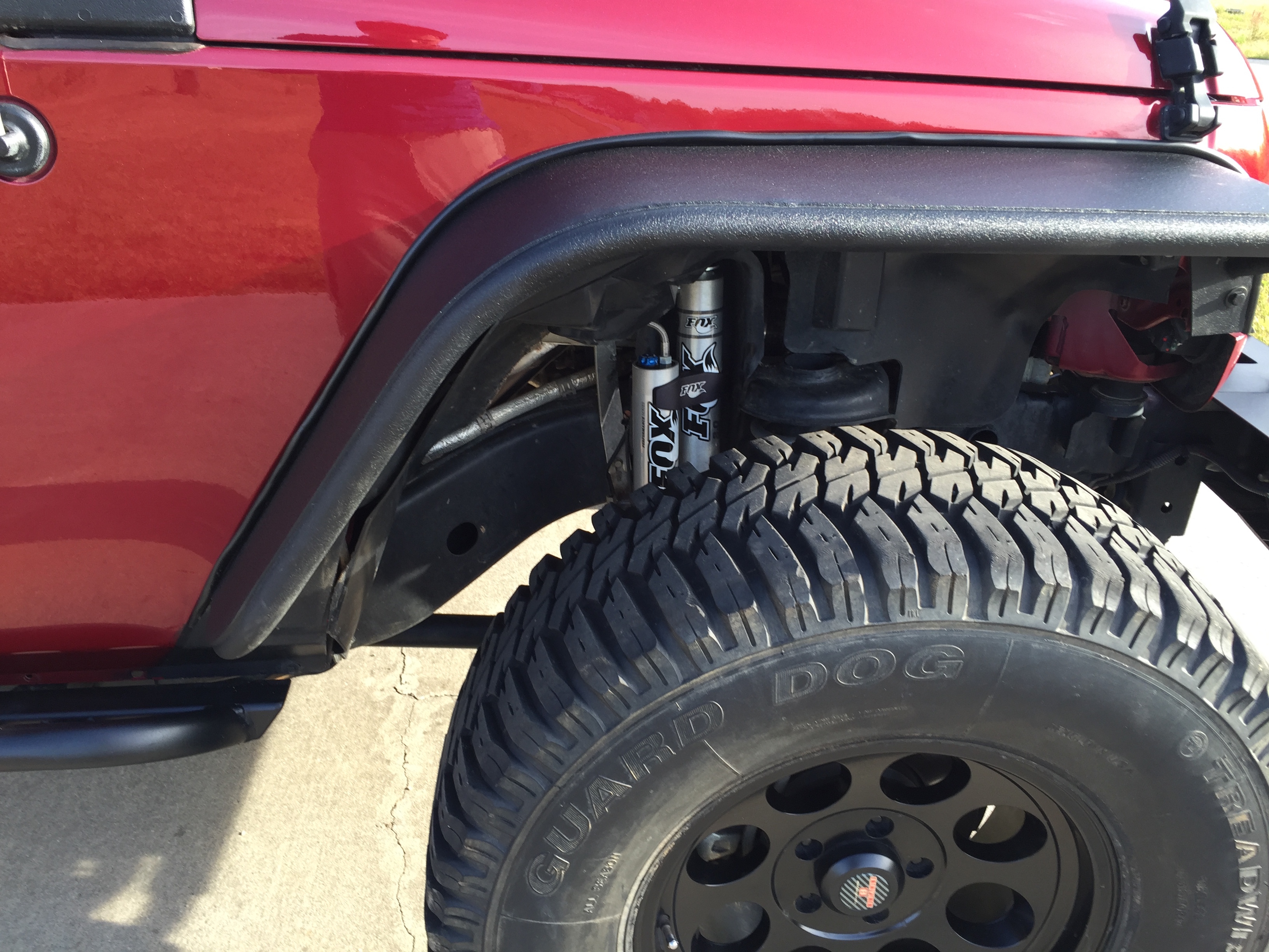

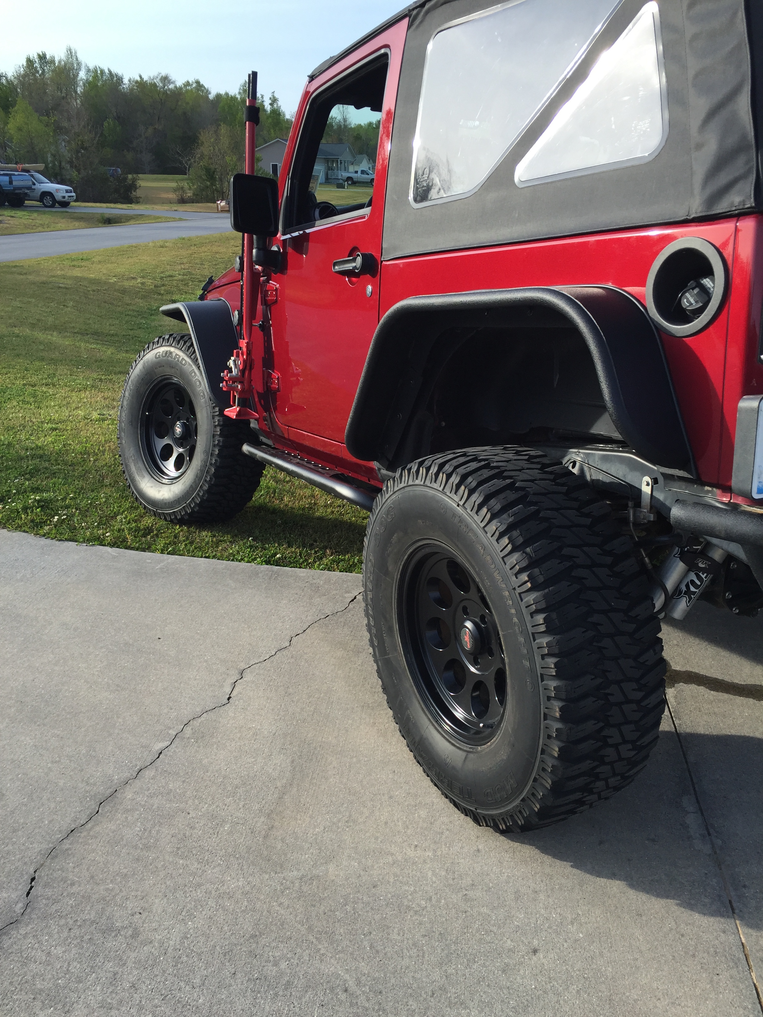

LCG is great. Your Problem is going to be clearance. If you want a Long travel like 8" or more your going to have to do some cutting with a smaller lift and 35" tires.
I went with 3.5" lift and flats because I was rubbing like crazy and I don't want to put in limiting straps and Huge bump stops it defeats the purpose of Long travel shocks or a coil-over system.
To some my Jeep looks over lifted or Goofy I really don't care. It functions on the trail and thats what I built it for I would rather have space to move up to 37" tires or Just have space to ensure I won't rub. I'v seen people rip their OEM fenders straight off going up Ledges and rocks.
