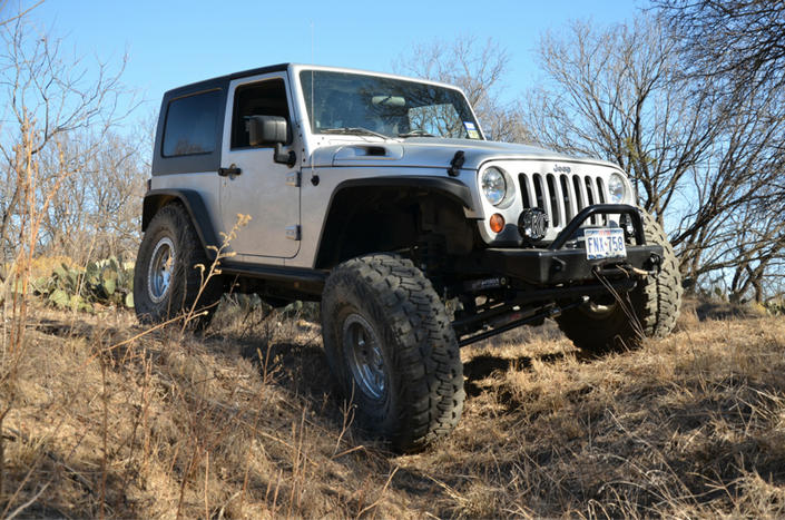

PSC is the only way to go I'm running a 3 inch lift kit with 40 inch tires.
I'm running nemesis fenders I gained 3 inch inches of clearance.
Once you get above 35 inch tires everything changes.
also going to need a set a heavy-duty ball joints........ won't last 15,000 miles with tires over 35 inches
