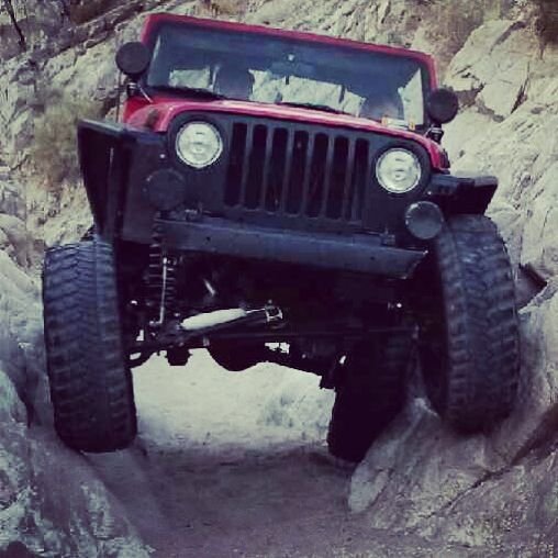

Thanks for the response everyone, being that i enjoy playing in the rocks here in SoCal I understand their good until they “aren’t” but I think they should hold up in the following terrain, thoughts?

Your locker doesn’t care about flex, climbs, or being tippy. It only cares about stress it’s under, that only happens when there’s a force on it from large tires or a heavy right foot. Bottom line, be easy on the gas and don’t race over obstacles and you’ll be fine.

Thanks for the input dude, I thought maybe the stress of one tire going over a boulder or crawling thru rock gardens with uneven pressure on each side of the axle would have some influence on the stress on the lockers, I've only had auto lockers in my previous TJ so I may need to understand selectable lockers better. I appreciate the response dude!
