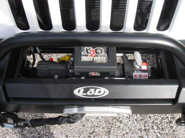

I ran mine the same way, up under the grill, down the passenger side to the battery.
