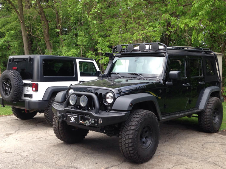

Old May 18, 2015 | 03:26 PM
jkd3624's Avatar
Posts: 354
From: lisbon ny
Call discount tire they helped me pick out mine no rubbing no issues. These have 35's on them and a mild lift.

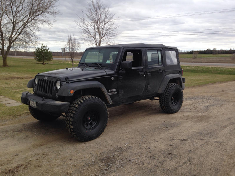

Old May 18, 2015 | 05:04 PM
Sjanov94's Avatar
Joined: Jan 2015
Posts: 109
From: Pittsburgh PA
ID:	611327 Here's my 15 in wheel, I love the 15 in wheel look. I got 15x8 fuel Lethal wheels, and 33x1250 tire.
