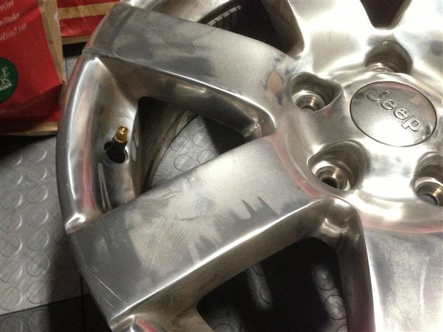

I'm going to get these 7 spoke 70th anniversary wheels powdercoated this weekend but the valves are still on. How do I remove them so that the wheels are ready to be painted. Thanks for the help!

Special tool or take to tire shop.

Just pull them out and get new ones.when you get the tires mounted

Use a razor to cut off the bigger section on the inside of the wheel. Then you can pull the rest of the valve stem out with your fingers or pliers.
You definitely want to put in new valve stems when the time comes anyhow. They are such cheap insurance.

That's what we did at belle tire .works like a charm
