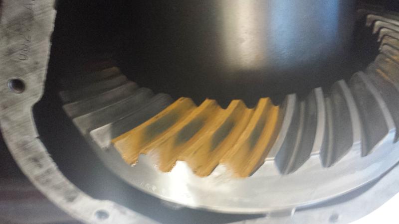

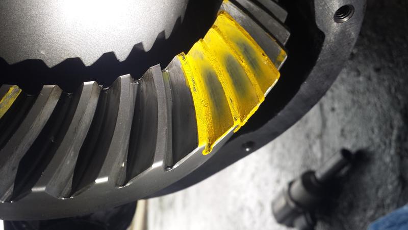

I'm doing gears and I just ran a pattern check. How does it look?

Looks good to me you can watch this video to kinda get an idea
http://youtu.be/tf9B_O4iYEs Skip to 13:50

pattern looks good to me, working on a set of gears myself
