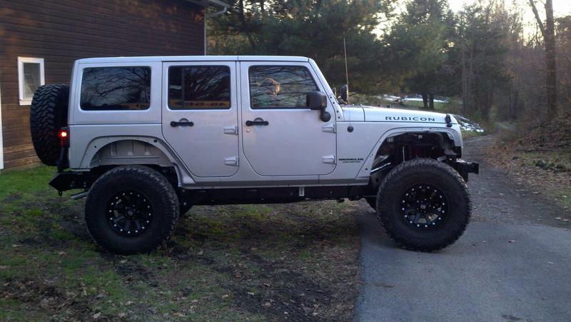

Ok so i installed a Rock Krawler 2.5 max travel with blisteins and a rough country 1.25 body lift with 17x9 addicts with 37/12.50/17 cooper stt. I am very happy with how well it flexed out and the extremely beefy control arms. But the ride is a little stiffer than i was expecting. All i read is how well it rides. Right now i am running no rear swaybar front manually disco and 18psi in tires its a little better on the road. My previous ride was a 09 with a 2.5 procomp same 37" tires it flexed out good and rode like it was on air so nice. The rock krawler kit is 100 times better but how do i get that nice soft ride change the shocks or the springs and if so which brand? Any info would be greatly appreciated. Attached are pictures of my old 09 and my new 2012.
