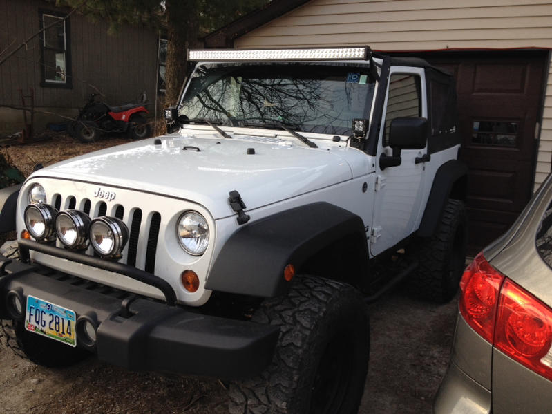

I have a 2dr with a 4" lift & haven't had to make virtually any changes to my lines & housings

Here is a picture of my wrangler.
