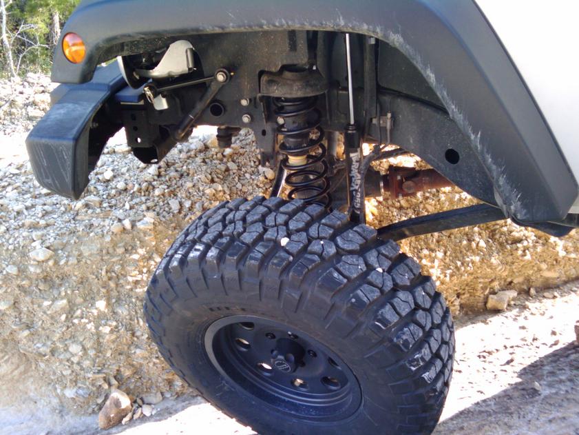

OK, so I have searched the forums for over an hour now and I can't find any pics on a solution for keeping the front coils seated under full flex. I have a 2.5 inch Tereflex lift and Tereflex quick disconnects in the front. My problem is that my front springs come unseated from the lower mounts under full flex and you can basically pull them out with very little effort. Has anyone come up with a solution for this? The lift is installed correctly with all of the parts used and double checked. Any input, with pics please, would be greatly appreciated. Thanks!

I have the Tereflex 2.5 inch spring lift and the 9550 shocks. It only happens when my front sway bar is disconnected. The shocks extend enough to allow the springs to be pulled out, but it really bugs me that sometimes the spring will reseat itself on top of the spring seat and pops back in to place after a little bit of wheeling. I have never had one pop out, but I just feel that it is a matter of time.

that's some nice droop!! seriously man, i'd be happy that you are having this problem! I wonder if those shocks are longer then my rusty's ones....
Your brakeline and abs wire look pretty tight there bud, might wanna address that too.

Yeah, the brake lines and abs lines are tight, but that is max flex. Next mod is stainless braided brake lines all the way around, but I am planning a trip tomorrow and would like to see if there is any other way to secure those springs. I was very pleased with the amount of suspension travel, but it has presented some problems that I need to address. I have done some trail riding and never even got close to max flex, this was a test trip and we tried to get it flexed as much as possible. If you look at the top of the spring in the last pic, you can see the top of the spring has come unseated. This was after we gave it a little tug to seat it back on the bottom mount. There is no way it will pop out from the top because of the bumpstop and the spring guide, but the bottom is just that little stub and I would prefer it to stay seated on the bottom rather than the top.
