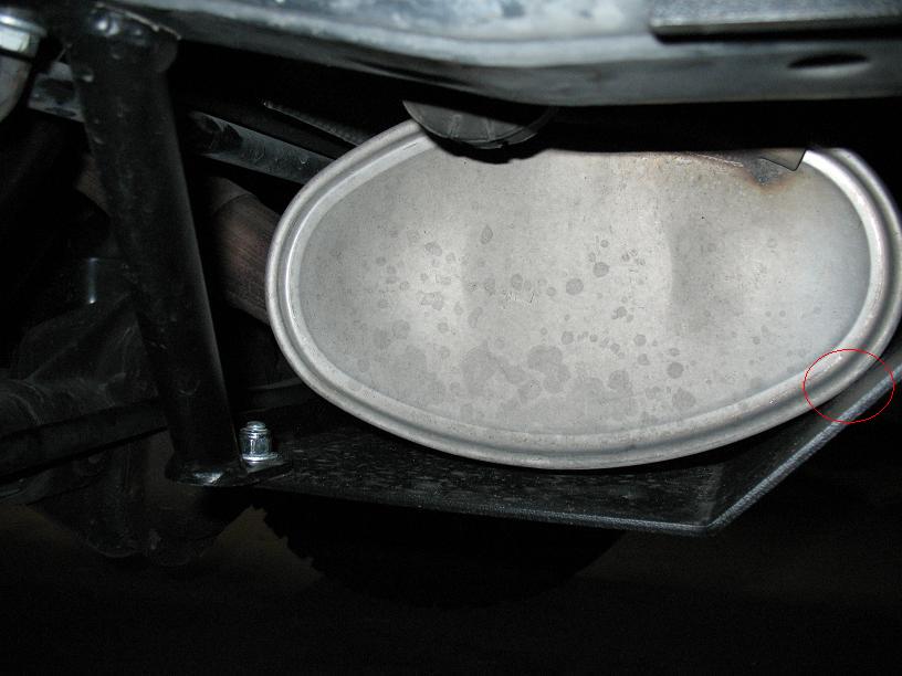

I'm confronted with a problem with my Rock Hard 4x4 rear bumper with skid, see below...
The muffler is touching the skidplate on the driver side (not the passenger side) and is causing my entire jeep to vibrate when doing low acceleration. Any idea how I can move this out of the way (the muffler)? I can't move the skid as it is attached to the bumper. Pictures would be appreciated!

Heat and bend the muffler hanger

x2! Just heat the hanger with a torch and bend until everything clears.

Go buy a small propane torch from local hardware store for like 20 bucks. or take it to a muffler shop have them put on a 6" by 18" muffler. You could be real lucky and have a fellow jk'er around you that will have the tools and can help you.
