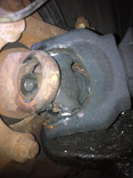

How much damage did I do?

from the looks of it you might need a whole new axle shaft. looks like the yoke on the inner shaft got bent a bit

If any of the holes that the u-joint cap mount in were wallowed out. That shaft will have to be replaced. Whether it be the stub shaft or the axle shaft itself.

This is why a lot of guys are tack welding the u-joint caps directly to the shaft itself.

Three hours away from home. Can I drive it back home to get fixed?
Old Oct 7, 2011 | 09:42 PM
jksteve89's Avatar
Posts: 329
From: Anchorage, AK
My buddy had this happen. We pulled the axleshaft out and he drove it home. Thats what I would do if you have the tools. Its your call though.

How do I pull the axle shafts out??

Just have it towed. It will be cheaper for you.
