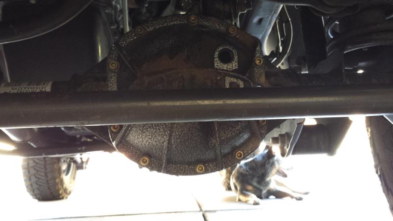

I've always heard just below the fill hole, but my aftermarket cover's fill hole is much higher than the stock one. Doesn't over-filling cause problems?

Yes, overfilling causes problems the least of which is blowing excess out the vents. Check with the cover manufacturer to see the rec fill for their cover. They are all different.

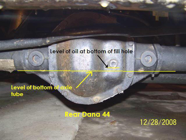

The quantity number doesn't matter.
What's important is the oil level is high enough to get out to the axle bearings in the rear axle, and high enough to lube the carrier bearings in the front axle.
To meet these requirements, the oil must be a little above the bottom of the inside of the axle tube.
For an after market cover you will have to use a small dip stick, and use it to ensure the oil level is at the correct level.

This was posted on a forum and is the method I used to get it right. Makes complete sense. Basically gets you to the stock level (easier if you have an ARB diff cover with the dip stick).
