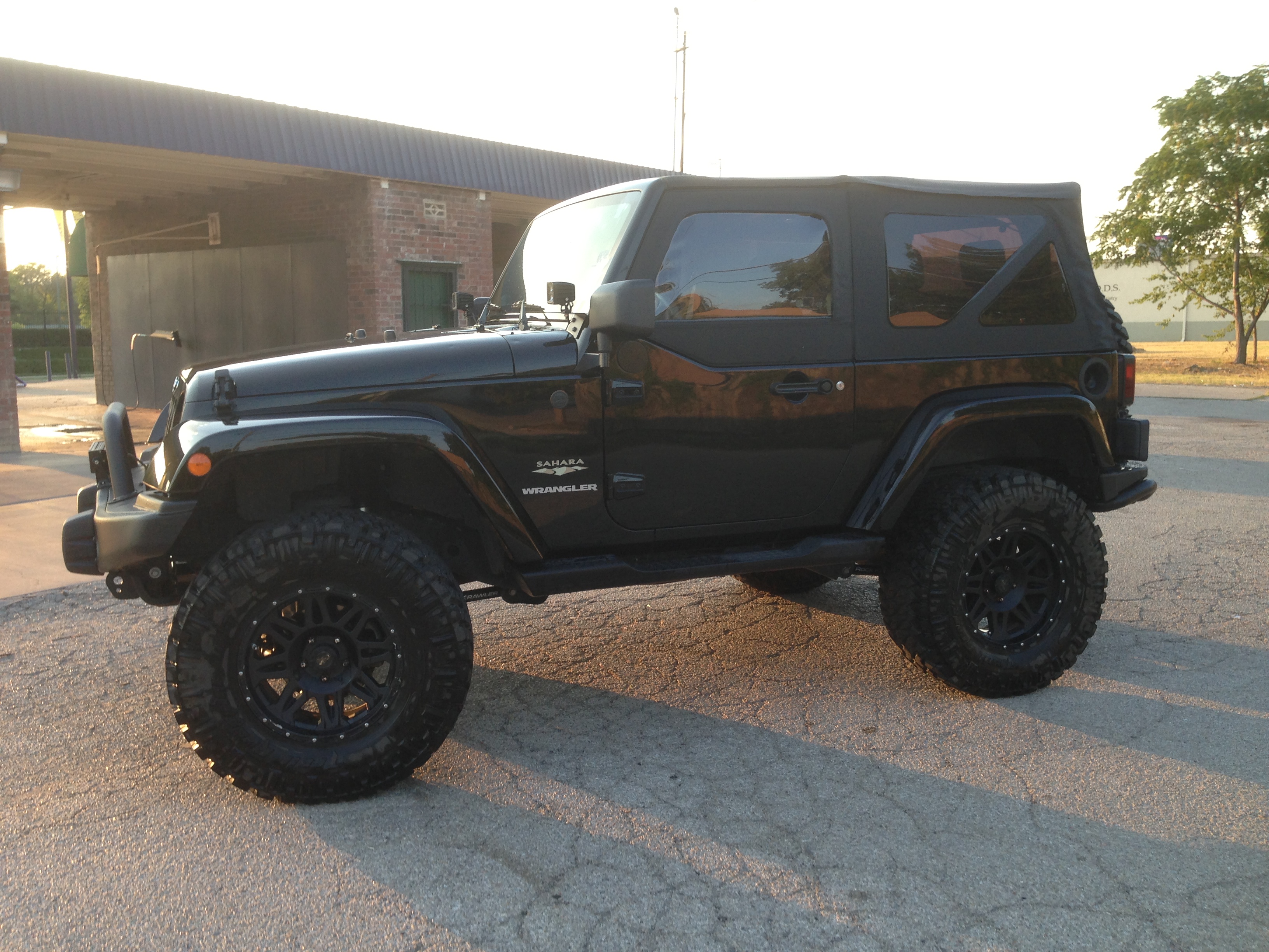

First day with the Rock Krawler 2.5 X-Factor with front and rear AEV bumpers:

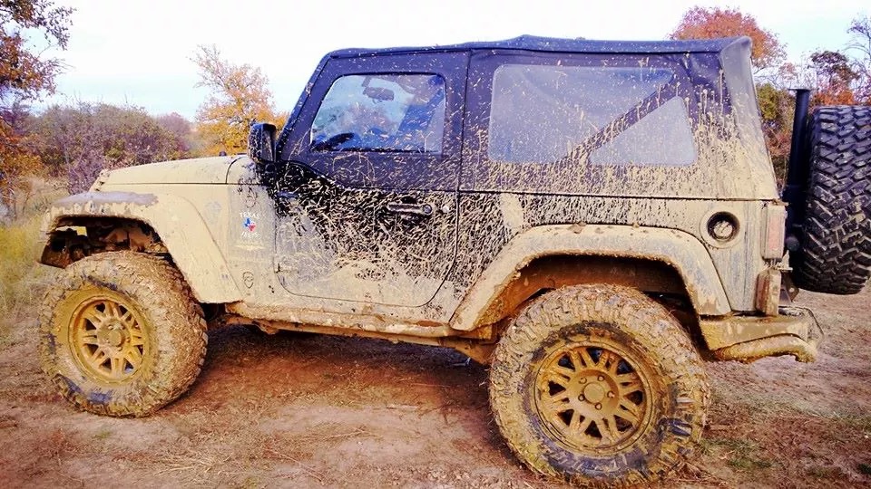

2 1/2 years later...only extra weight is a Warn Zeon 10-S, and the AEV rear tire carrier on the rear:

First day with the Rock Krawler 2.5 X-Factor with front and rear AEV bumpers: <img src="https://www.jk-forum.com/forums/attachment.php?attachmentid=632631"/> 2 1/2 years later...only extra weight is a Warn Zeon 10-S, and the AEV rear tire carrier on the rear: <img src="https://www.jk-forum.com/forums/attachment.php?attachmentid=632632"/>
Your rear deff sagged after the tire carrier. Same with my rk 2.5 coils. Gonna find some 3" coils for the rear.
