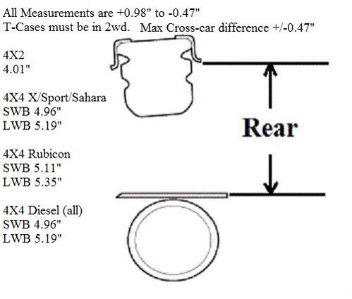

In need of new rear shocks bought my 2011 jk unlimited sport used and lifted is there any measurements or way to tell how much lift you have?

Like that, although I think there is a different one for an exact on the rear but I don't have that one on my phone

And now I have both on my phone, thank ya
