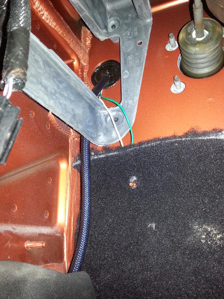

I ran my wires through the hole under the dash.
Attachment 553401
That looks like the penetration that would be used for a clutch on a standard transmission model. That's an easy one to get to and use. There is another one behind the brace to the left of that hole as well. I prefer those to the foam filled hole on the fender as things are better hidden and there is no potential for door interference.
