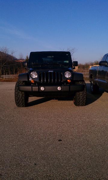

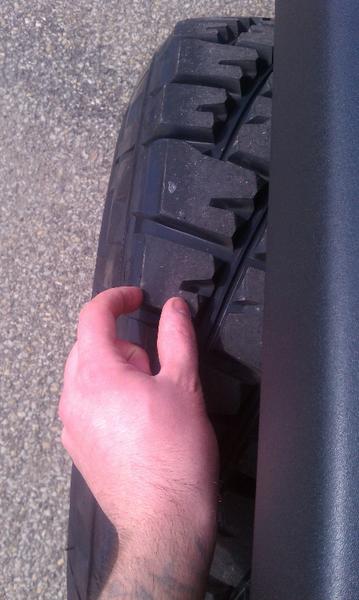

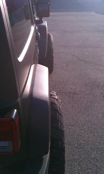

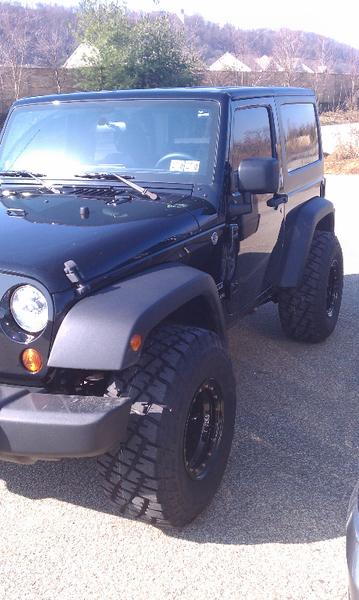

I don't know if this will help or not...but i have 33x 12.5 x 15 tires on 15x10 wheels with 3.75" backspacing. they stick out a lot. Definitely not passable by inspection.
But i love the aggressive stance. its worth swapping out for the stock wheels once a year for inspection.

Oh and those pics were taken beforee the lift

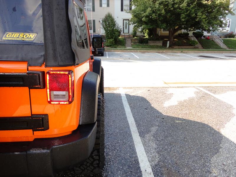

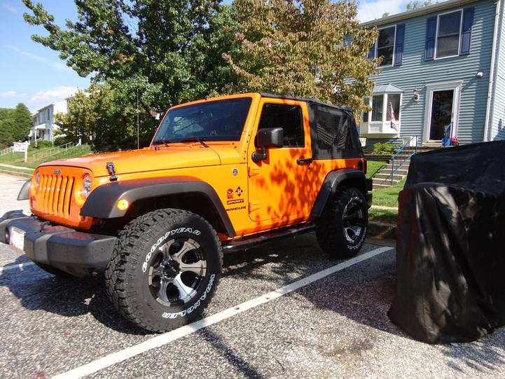

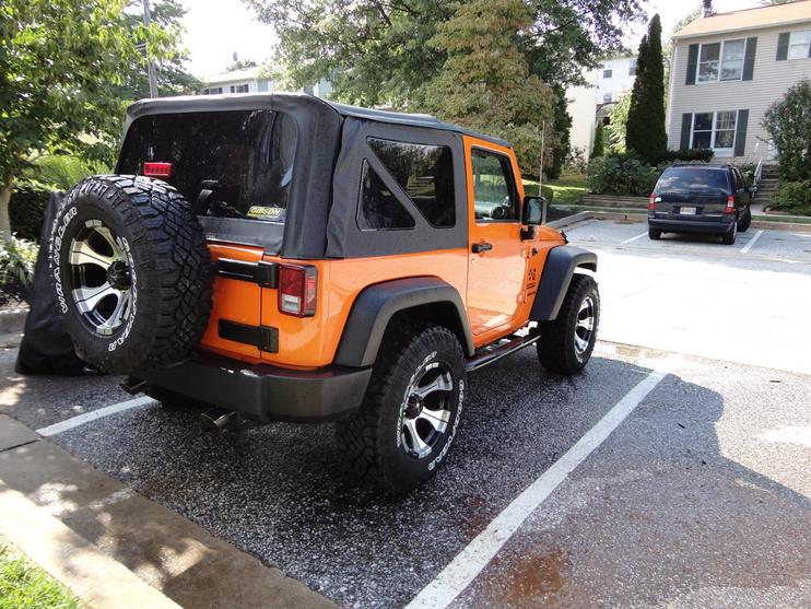

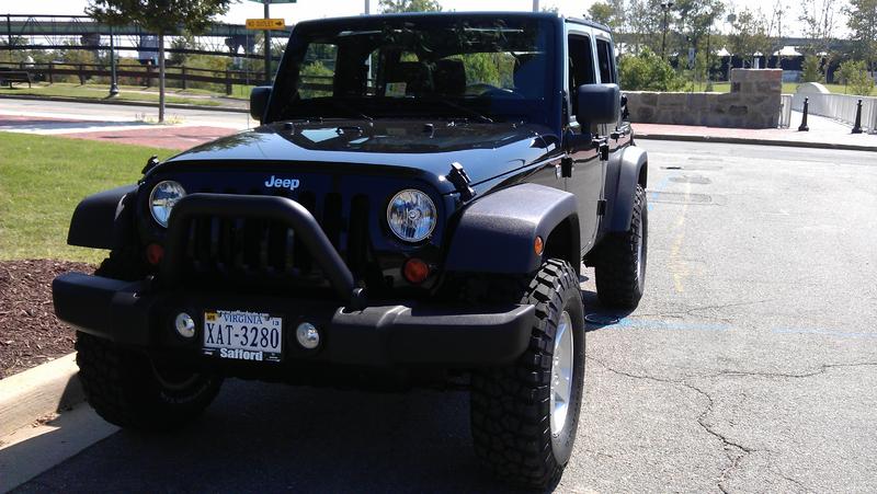

I've got some 285/75/17 KM2's, i put them on the stock wheels without wheel spacers and had no rubbing at all but it was tight, they're 11.3" inches wide and right under 34" inches tall. They looked a bit too tucked into the fenders so i added the 1.5" spacers to get the look i wanted, now they stick out past the fender about 1/2" at the most but thats a huge difference to me stance wise.
Originally I wanted to go with the 305/70/17 KM2's they are the exact same height but they're 12.2" inches wide, if i had chosen these tires i would of def had gotten new wheels (weren't in my budget unfortunately ). I think they would of stuck out too far past the fender with just the spacers but then again someone else might like that look.
Just my
Good luck with the desicion making, it kinda sucks when choosing wheel/tire combos way too many options...lol
Not much of a straight side shot, best i had
