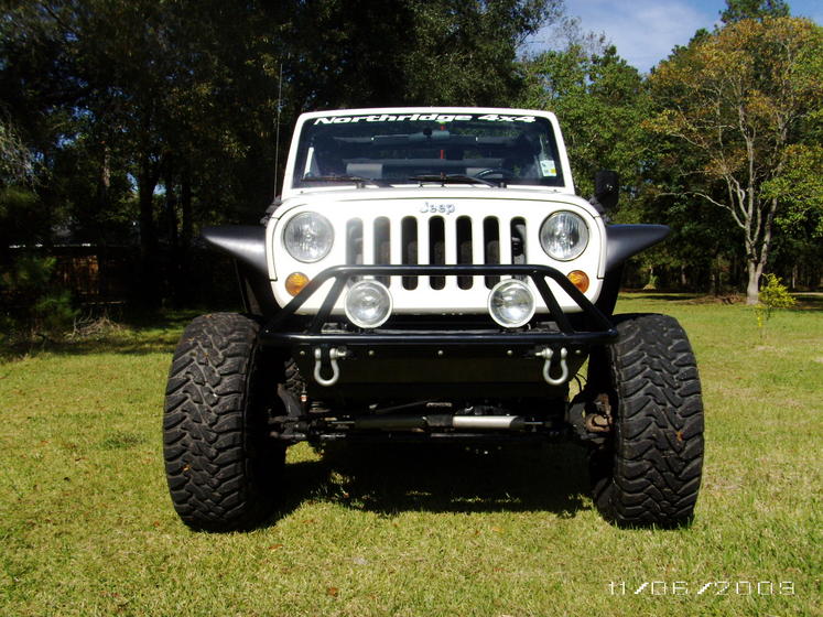

You can run 12.50's on a 8in wide rim, I did it on my 35's and now on my 37x13.50's.
