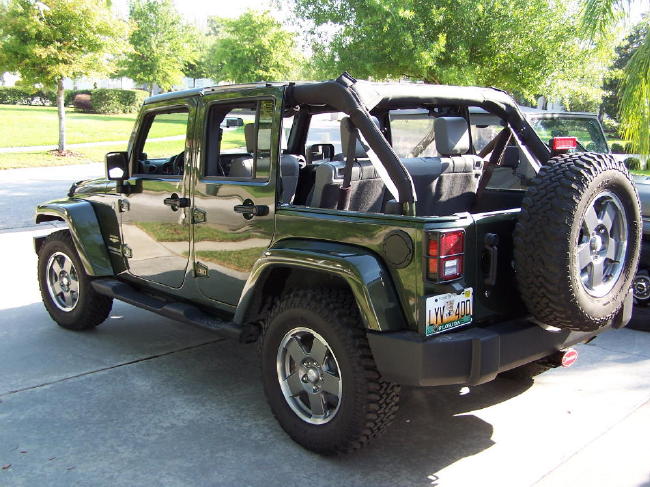

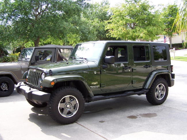

No modifications necessary.
Get em!

So is this a different rim .. center looks like it is different.

Yeah, that's a different rim. Not sure what that comes off of.
If it's off of a commander it will fit. Looks good.

Yeah its off of a commander. this is the wheel I want .. again from a commander.

These are not from a Commander, they are from a WJ...
