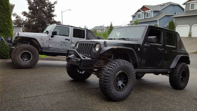

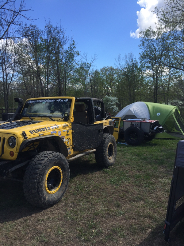

I have method beadlocks on my DD. 37's
No issue never found a loose ring bolt. Very happy. 20k miles per year

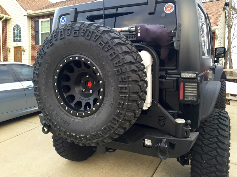

Don't know about the Hutchinson wheel as far as issues, never heard anything bad but I-myself plus my son are running the Methods and we love them, no issues at all and run as high as 75mph on the highway, we've been running them for 2 years now. One thing tho, my son is running a MT 35" Claw and the rings fit fine out of the box, mine tho are 37" MT MTZ-P3's and they have a thicker bead so measure your bead (mine was 0.800) cuz if it's that thick you'll need ring spacers but no issues on them at all.
